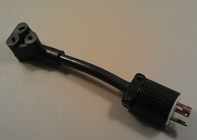

I remembered I still had my pigtail I made from my old RV/gen setup, so I took a photo...

Started looking after this and found they do make an adapter, didn't know they did. I also found out I have an L14-30 outlet on the generator so it has four prongs not three. That translates to three times the money for an adapter. Oh well, for $29 on Amazon I found the right one. Thanks for the reply. Feel much better about hooking up the AC now.

This is the adapter I found on Amazon:
http://www.amazon.com/Camco-55382-Generator-Dogbone-Inches/dp/B0024...
It appears to be used specifically for this. I wouldn't think that 120 volt plugs would be 4 prong, they appear to be the L5-30 plugs which are the three prong ones. I have posted a question on the Briggs & Stratton site my generator (Storm Responder 5500) to see how it works. They also say it has an automatic voltage regulator but I think that is for cleaning the power not for changing the volts. Most electrical stuff makes sense to me, this is confusing. Trying to have this genny do double duty (it was bought for an ice storm a few years ago). Since it is on wheels and I have a ramp on my rig, I want to use it. I don't do much in the way of primitive camping anyway but when I do, it is nice to have it.
MrSteve
Reg. Jul 2012
Posted 2013-03-24 9:20 PM (#150821 - in reply to #150778)
Subject: RE: Brigs and Stratton Generator
Posts: 109
100
Location: Florida
Ok, that will work... I made sure to read the product description and it did say 120v, With that said they made the plug with one blade dead, I can only assume it is wired correctly or they wouldn't be selling them. So you are good to go imo with that product.
