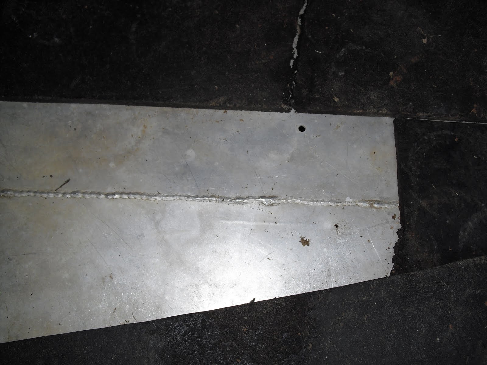

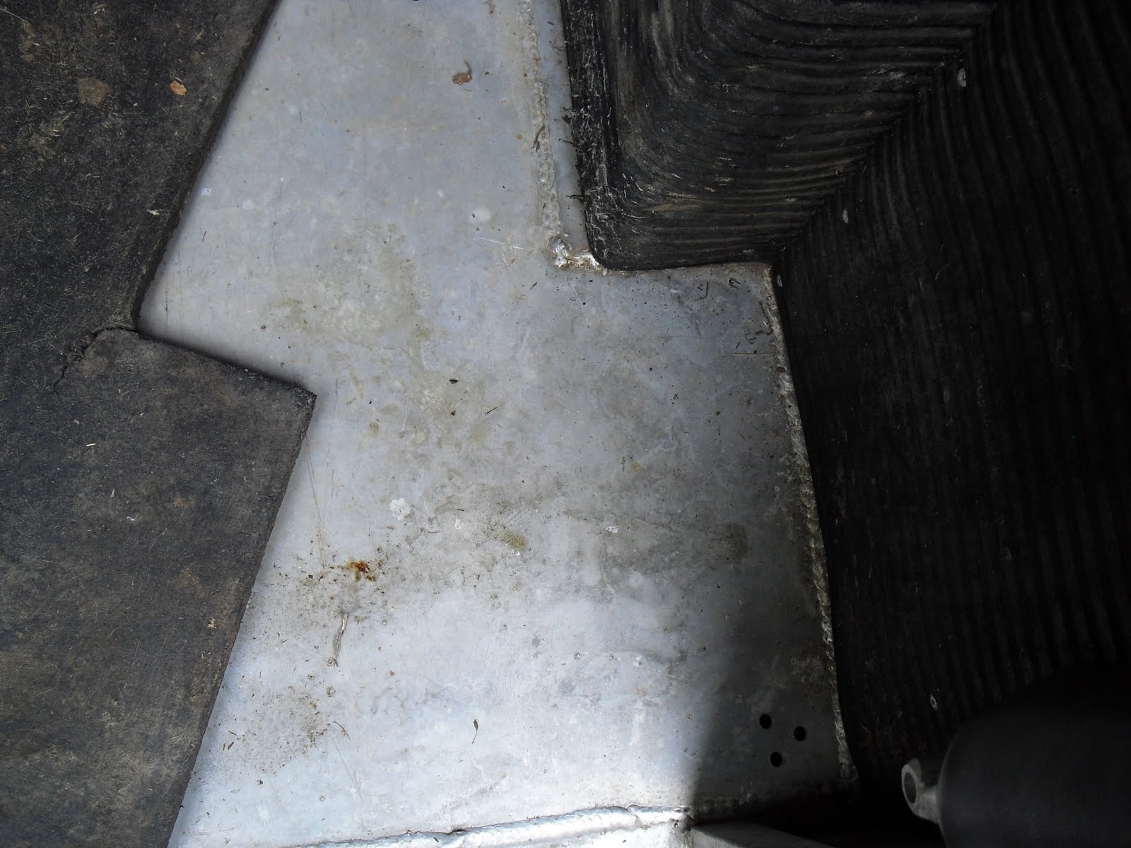

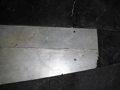

I tried to post the pictures, but it would not let me  - so maybe Retento can work his magic and get them posted here.
Anyhow, I posted several pictures of my trailer floor on my blog (bottom of May 6 entry) - what do you look for?  Does this floor look OK?  The gentleman I bought it from said that he cleaned it out everytime he used it.  The trailer is a 1992 4Star - still has original mats.  If this floor looks OK would you recommend putting WERM on a floor that old (after proper preparation) or should I just get new mats?

Dang,that's a 1992 floor??
I certainly would not replace that floor or put down WERM.I might do Gard's special flooring treatment with Duplicoat over it to keep from ever having to pull those gigantic mats again (we have a 2000 4Star 4H very similar probably) but other than that,this floor looks pristine compared to some that I've seen that are newer than this.

Pictures for alumimum floor question  -
Right rear of trailer - most used stall:
Close up of right rear
Center of trailer - gelding pee spot  :-)

The flooring is in excellent condition. The seller certainly did not exaggerate about his routine maintenance. It has been well cared for and certainly proves the longevity of aluminum construction.
It's difficult to see if there are many small brown spots on the metal's surface, or if it's dirt or just the computer's resolution. If there are spots, and upon close inspection, are found to actually be small indentations filled with a discoloured powder, you should consider acid washing the floor. It will stop any damage before it begins, and help ensure another eighteen years of service.
If you are satisfied with the mats, I would stick with them. There recently have been some postings about the Werm products. There seem to be as many owners dissatisfied with the product, as there are favourable reviews. The sheet flooring on older 4 Stars can flex a bit, and may not be an ideal candidate for the Werm. Perhaps Richard Smith @ Select Trailers could enlighten us on that topic.
I would acid wash the floor, rinse and let dry. This would be adviseable regardless if you plan on reusing the mats or installing the Werm
The flooring is excellent, and if the rest of the trailer has a comparable condition, you will have many years of future ownership to enjoy.
