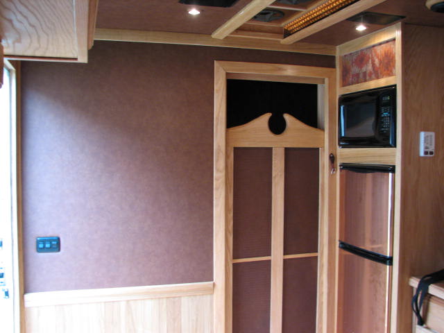

Location: NEW SMYRNA BEACH, FL | Thanks for the info...we are short on professionals here in my area but im still looking for someone i trust!! O.K...next ?...what to do with the walls!!! I dont want wood paneling! I would like the "wall paper" looking stuff but everything I find says not to put it directly to studs and also says not for use in mobile homes because of formeldehyde (sp?)! Any thoughts..I thought of doing the vinyl but I have no idea what to put it on and what to put it on with. Anyone got pics of their walls that are not wood paneling? |
Posts: 1283
      Location: Home of Wild Turkey Whiskey | I use 1/2" plywoo from Home Depot it is very very smooth, if you line the walls with it then fill the seams with spackling, you can then wallpaper just like a house.
The wall vinyl or soft walls is done the same way, I just use ac plywood because it doesn't need to be as smooth.
Good luck on your trailer. |

| At our Lowe's they have the kitchen countertop...topping I guess it is. It comes in sheets for someone who is making their own counters. The sheets are about 1/8" thick and have the wallpaper "swirly" look to them. They seem like they would be very durable and washable. I am considering glueing them to 1/4" plywood. Couldn't find them online, but they were in the store. |

Location: NEW SMYRNA BEACH, FL | Thanks for the pictures of the walls / wall paper. They look great...(the walls that is!) Back to electric stuff... I am attempting to keep cost down as much as possible for right now. Can I install the 12v lighting etc... and run it off of "shore power" without having the batteries. Then when the money builds back up add the batteries etc. I saw the post about the converter thing, but am still a bit confused. If this is possible..what would be the easiest way to have the stuff wired so that we can add batteries? Also...I was thinking of adding propane at a later date as well. Should the lines be ran now, before the walls are up, or can that be added later without alot of heacache? |

Posts: 3
Location: Washington, State | The wallpaper looks great! Do you attack the plywood directly to th emetal studs in the trailer or did you add furring strips? Thanks |
