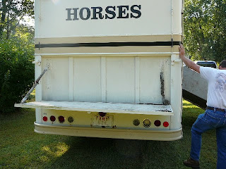

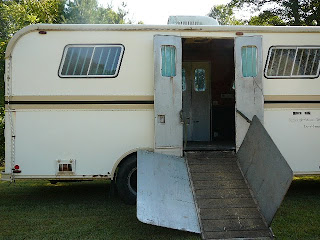

Pictures - and they actually posted this time!!
This is the side where the LQ is going to go.....
Posted 2009-09-05 8:16 PM (#110329 - in reply to #110317)
Subject: RE: I just bought a new project!!!
Looks like a MV404 or MV446 engine... Love that padded up TWH on the door... Don't you dare take that off!!!
